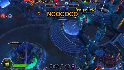

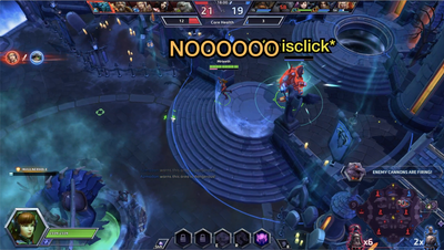

I have recently discovered the apparantly quite common problem that the colors when I export my video with H.264 looks "washed out". I'm using Premiere Pro 14.1.
This is how it looks in Premiere, Quicktime and VLC respectively. VLC looks... better. And I've heard that Quicktime is notorious for changing the color of videos. But this extends to the web and watching it on Youtube, both on a Mac and Chromebook, it still looks washed out. Chrome on my Mac looks a bit better, but still not what it's supposed to.
Reading up on this I found a LUT that should apparently fix the problem, making the exported video look like it does in Premiere. The problem is that I have edited with Display Color Management off, and using the LUT makes the video look the way it does with DCM turned on, which is way too dark.
I therefore have the issue with my video getting too bright when I export it normally, and too dark when using the LUT that is supposed to fix the problem.
I just don't know what to do. If I should export in a different format, use another LUT I don't know about or do something else. If this is just because of my computer, wouldn't I want to change it so it will look correct for most people? Or should I just cut my losses? Thankful for any help.

hey this is a common issue when grading on retina displays - i'm sure you've seen the forums (https://community.adobe.com/t5/premiere-pro/washed-out-colours-when-exporting-as-h264/td-p/9709377?p...)
and here
https://community.adobe.com/t5/premiere-pro/exported-video-looks-totally-different-on-youtube-than-i...
but basically from what i've seen the only way to completely avoid this is to grade on a calibrated external monitor set to rec709 (not the p3 gamut of the retina display. it has to do with the gamma of the program monitor which is rec709 and the gamma of exported file which is srgb/rec709 (i believe) (at the time i read this)
without a reference monitor you have to split the difference between what you're seeing and what you want and just realize that even once you get it looking exactly how you want it to look on your monitor, the viewers are going to have completely different setups that looks completely different regardless, and they isn't anything we can do about it.

Virality did a great job of a quick summary of your first question/problem. Essentially, you are trying to correct color and then view it to check it ... using a non-standard-compliant monitor for video media, and then checking it on an app without correct color management. I'll add in ... with the added issue that the Mac ColorSync utility does not properly apply both the scene and display transforms to much Rec.709 (video) media.
That was why he was referring to viewing video images on a properly calibrated monitor.
