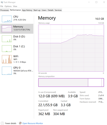

I edit for a living so it is frustrating that any change in my timeline on Premiere Pro, it lags.  I have to constantly wait a few seconds with each change. Obviously, this isn't sustainable so any help would be REALLY appreciated. I have followed every youtube tutorial on the settings inside the software to make it run fast and nothing has helped. Today, I ran the task manager (shown below) and this is when I realized when I  play the timeline in the software, the memory shoots up to almost fall capacity, so I'm guessing this is the main problem... I need more RAM. I'm Just wondering if it could be anything else? Do I need an internal SSD storage, if so what for? Could it be the latest prem pro Update? What RAM should I get? Can my GPU be used more or not?

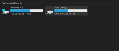

Sorry here are the images:

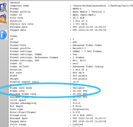

Oct 12, 2020 Oct 12, 2020
ya gotta scroll further down and you'll see constant or variable frame rate and the approximate frame rate, etcScreen Shot 2020-10-12 at 5.09.13 PM.png
