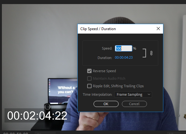

Thank you for your answer. So I did that and it adds 4 seconds to it
So i ahve the transparent video, added the timecode, moved it where i wanted it i changed the TimeCode to generate so that i could have the starting timecode to start at 2 minutes. I then do that and it add 4 seconds to it.

Ok so i did all of that just for some reason it adds 4 seconds to the 2 minutes
Explorer ,
Dec 27, 2017 Dec 27, 2017
If i go to the speed duration and change the 4 seconds to 0 the clip goes red

Sorry i had to actually make the transparent layer longer to where i needed it so now it adds 3 minutes to the 2 minutes now.
Explorer ,
Dec 28, 2017 Dec 28, 2017
I got it working yesterday. I had to mess with the time on the layer so when it added the minutes it equaled to 2 minutes. Then it work i just had to mess around with it for a long time. Thank you for your time everyone!
