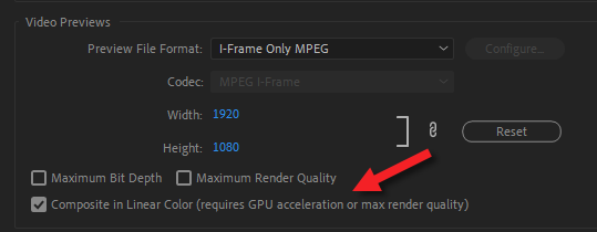

BTW AH,
Is it this you are referring to?
Votes

I do always un-check "Composite in Linear Color" every time i create a sequence though i always use the Film Impact transition as well.
I have asked Adobe why "Composite in Linear Color" is enabled by default though it creates so many problems over and over again for users but never got an answer. I did also ask what "Composite in Linear Color" actually does, what benifits, if any, it does it give me, in what situations i do need it and in what situations i don´t. Never got a reply.
I have seen several documentaries on TV that one could see by judging the look of the abrupt transitions that it was cut in Premiere Pro. That´s really sad.
Adobe did fix this issue back from time to time in CS5/CS5.5/CS6 updates but they stopped adressing that issue when CC2013 hit the market. (And i stopped filing bug reports over and over and over again about it...)
Votes

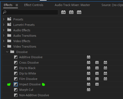

quote
But as u can see, the rest of the Film Impact plugins installed properly, but not the Impact Dissolve. Maybe bcz Im on latest Premiere 2023? THANKS AGAIN!
By @JasonL_OHA
I am on CC2023 as well and have the old Transition Pack 1 and Transition Pack 4, iow before they went subscription. That should not matter though, according to their site it should be available in their subscriptions as well, Essential/Visions/The Big Bang: Best Cross Dissolve Premiere Pro | Free Video Transition (filmimpact.com)
Try to seacrh for it in the Effects panel:
Votes
Community Beginner ,
Dec 15, 2022 Dec 15, 2022
Copy link to clipboard
Copied
Even searching in the search bar just pulls up my old stock Premiere dissolves. See screenshot below
Does anyone have any uninstall instructions? I would like to try to re-install the whole pack.
THANKS!!
