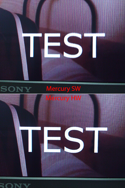

Any idea on why with CPU rendering DV output looks the same either if rendered or not (blurish)?

I've also taken some pictures to show output quality differences between GPU and CPU rendering but unfortunately they are hard to notice on the images... SW is blurred, HW sharper.

That looks logical, since hardware MPE always uses maximum quality and software MPE does not by default.
