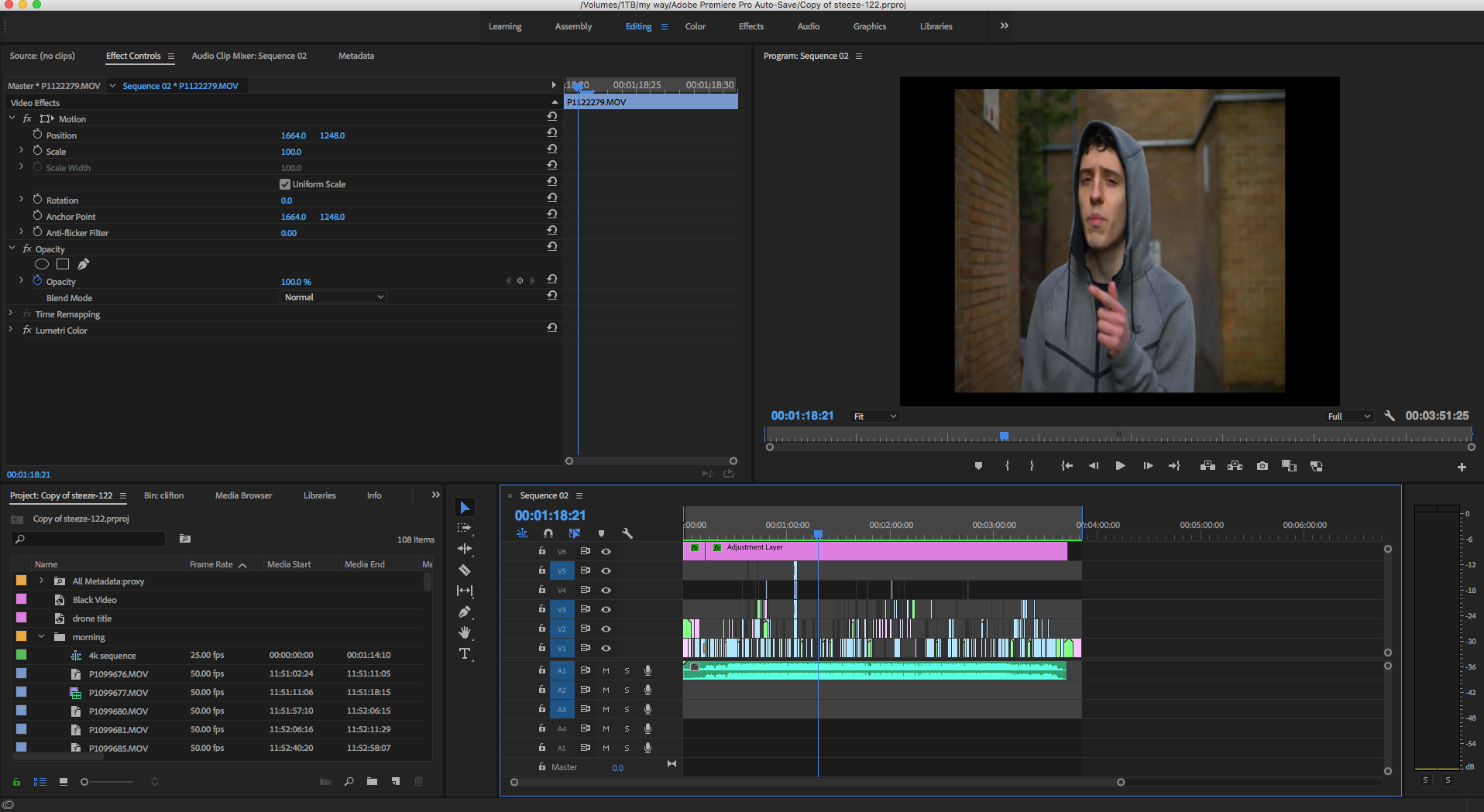

Here is a screengrab of the program sequence and the exported video.

You're looking at previews in that sequence, as I previously suggested.
Delete them.

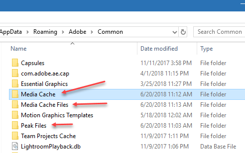

I just tried it on PP 12.1.0 (Build 186)
I created some proxies in a project, turned on the proxy display and left it with a proxy showing in the program monitor. Quit PP, Renamed the Proxy folder, Started PP with that project, Got the offline message and "Offline All". Project loaded and the correct preview was shown and toggling the proxy button did nothing. IE: All seemed well.
BTW: I keep a shortcut on my desktop to delete the media cache folders once in awhile, or if there is (unusually) an anomaly. I delete these three folders and PP builds them right back...

Ah ok, so should I delete these folders?
Patch
Jun 20, 2018 Jun 20, 2018
Yes, or rename them. I just put an 'x' in front of the name.

Just did this and the footage appears to be back to normal!

Yes, I just delete those folders, but if you are 'squeamish' renaming them will suffice!

So a 1024x540 default proxy will work with the 4096 footage, but if you use that with 3840 footage you image when viewing proxies will be squished in and have bars on the side. Just from viewing the 1 frame of your guy in the grey hoodie, obviously it has the bars, but it also appears a bit squished in to me.
