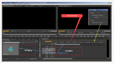

In the attached image a sequence of stills is loaded (Sequence 01). It also appears in the Time Line but does not appear in either the Source monitor nor in the Program monitor and scrubbing through the Time Line shows no images no matter how much I click and drag the sequence into them. Another oddity is that, even though the Project Settings stipulates a "Frames" display format, the Time Line shows "Time Code" instead.

Hmmm.. I don't see any imported image sequences in the project panel, there is only an empty sequence that is created inside of Premiere Pro.
For the timecode try to ctrl + click on the yellow timecode of the timeline, it should switch to frames after few clicks
Aug 07, 2021 Aug 07, 2021
Your timeline/sequence is empty.
If there were image in the sequence they would show in the project pane.
Must have deleted the images somewhere along the line.
Frames will show when you make a new sequence when setting in the project settings.
They will change instantly when you change them at the playhead position (top left corner).

Thanks for the help. I've made some progress but there is one step left. My sequence is loaded into the Project window. When I click on the sequence a yellow bar appears under the first image and I can actually scrub through all the images with it -- terrific! The next step is to get this into the Program and Time Line monitors. That should be simple but I tried dragging the sequence into them but that did nothing.
Aug 08, 2021 Aug 08, 2021
You dont have a  sequence but an asset which looks like an image sequence.
An image sequence is one movie clip which what build from a bunch of stills.
Drag it into the new item icon to create a sequence that will occupy the timeline.

As Ann said before, drag your imported image sequence into the new item icon to create a sequence that will occupy the timeline (see her attached picture).
