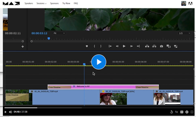

Case in point...If you go to this class Fast Cuts and Creativity: Quick Video Editing Techniques - S604 in this year's Adobe Max.   You'll see at 4:46,  Maxim selects the clip (which happens to be a title), presses Shift + D, it adds the default (Cross Dissolve) to the beginning and the end of the clip:
Is this a custom shortcut???  I just went and add a lower third to my video as a test, selected it, pressed Shift + D and it did apply the default transition to the beginning and end of the title.  Why doesn't this work for videos?

Nov 20, 2022 Nov 20, 2022
From the "Keyboard Shortcuts" dialogue box:
Shift + D: Apply default video transition to selection.
Ctrl + D: Apply video transition.
Anyway, I use Ctrl + D all the time and it works with selections and at edit points.
It does work for videos.
Select a video clip bondary that has a gap before it and a gap after it in the Video Track, apply video transition, and  and you should see the same results.  That is, the default video transition gets applied to the left side of the clip boundary with the Transition Alignment set to "Start at Cut" and applied to the right side of the clip boundary with the Transition Alignment set to "End at Cut".
If the selection in the Timeline is an edit point where a clip meets another clip instead of a gap, Apply Video Transition sould result in the Transition Alignment set to "Center at Cut".
