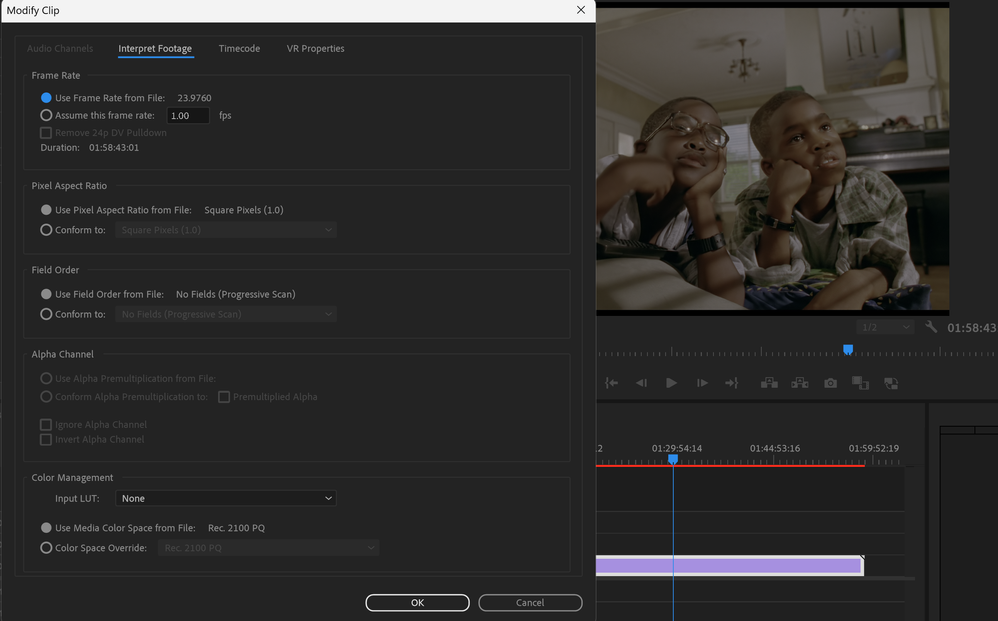

That's the problem. I open the footage and look at thte sequence settings.  Seem right
So I look at the interpret footage.  Looks right.
This is my settings when exporting
Problem then I'm left with the variance in color as originally noted.
