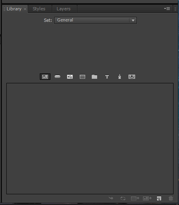

Quick question...where are all the templates for menus and such that usually came with Encore???
It's like it didn't install any of the Encore libraries?
Randy
Nov 07, 2020 Nov 07, 2020
No templates were installed with Encore CS6, but they are aviable here: Adobe CS6 Extra Content
You want to download Premiere Pro / Encore CS6 Extra Content. I never install them so i cannot guide you further but several other users here can.
Engaged ,
Oh it was super simple to do (although it did take me a few moments to work through the install).  All you do was to click on File 1 and File 2 to get them to download.  Once the BOTH have downloaded, click on the first file and it will begin the process.  Once they are both downloaded, go to where they downloaded to (I downloaded mine to my desktop).  Locate the Adobe CS6 file folder, double click on it, double click on the Premiere Pro Family Content installers folder, then double click on the Adobe Encore CS6 Functional Content folder, and then double click on Set-up.exe.  Once the dialog box comes up, click on Adobe Encore CS6 Library and click install.  If you had Encore open, you will need to close for them to load.  Restart Encore and the few templates are listed under the library.  It's not much but it will get you started.

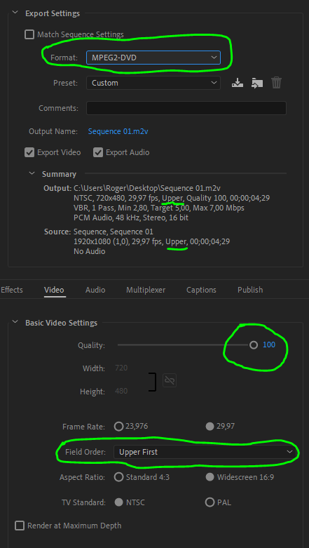

Nope, rendered from PP in HD and quality of video was great when I brought it into Encore.
DVD is per definition standard definition (SD) so you should render out SD from Premiere Pro, not HD.
For example, if you render out HD and choose to use H.264 it will look good when you look at it. But, H.264 uses hard comprerssion and when you bring that into Encore it will be re-transcoded to SD but now as MPEG2 that is hard compressed as well. Even if you bring in a high quality codec into Encore, Premiere Pro do downscale the footage way better than Encore do.
If doing DVD, only bring in SD assets into Encore. Use the MPEG2-DVD as Format in the Export Settings dialog and pay attention to the Field Order. If you use interlaced HD it´s always Upper while Premiere Pro for some reason year 2020 still wants to export it to Lower though it will look like crap, so make sure to change that manually.
And, downscaling HD to SD will always degrade the footage and Adobe apps are not the best ones when it comes to scale down video.
This image is just an example, so make sure to use frame rate, etc that matches your source footage.
