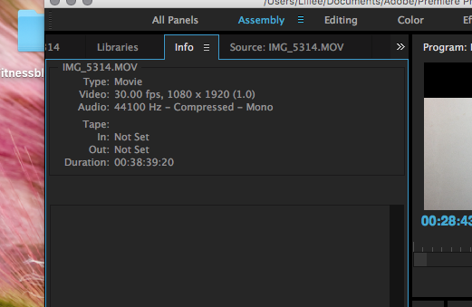

Hmmm, this is what comes up when I go to Window>Info

Feb 19, 2016 Feb 19, 2016
That's the info I needed. As I suspected, that's the problem. Under the video section is says "1080x1920" - that's the frame size of your video clip, measured in pixels. The frame size is always measured horizontally and then vertically. In other words, this shows that your footage is taller than it is wide - 1080 pixels wide, 1920 pixels tall. The good news: 1080 and 1920 are standard sizes; the bad news: they're backwards.
The solution: Create a sequence that we know is correct, and then add the footage into that sequence (no reinterpretation necessary) and rotate. What happens when you simply drag a clip from the project panel to the timeline is that Premiere creates a new sequence for you that is tailor made to that clip. That's awesome when everything is to spec. However, in this case it works against you because the video isn't to spec. So, we need to use what you did before but tweak it.
