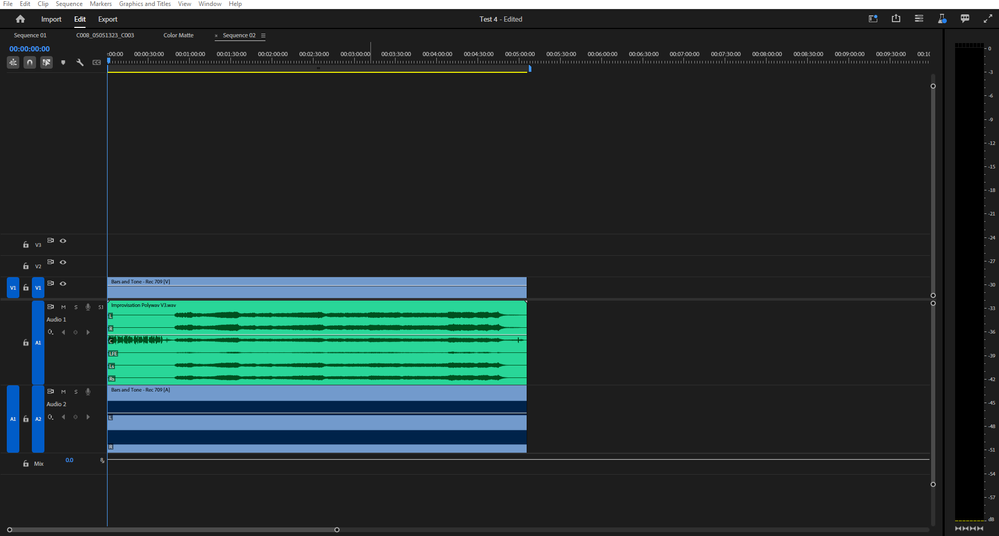

Like this? This is the source sequence where I have edited the video.
Enthusiast ,
Jun 16, 2024 Jun 16, 2024
Yes, but we need the whole panel, not just part of it. And for now, it seems you have not routed your audio at all? Everything goes to the mix track - and we don't see what your mix track is set to because we don't see the whole penel.

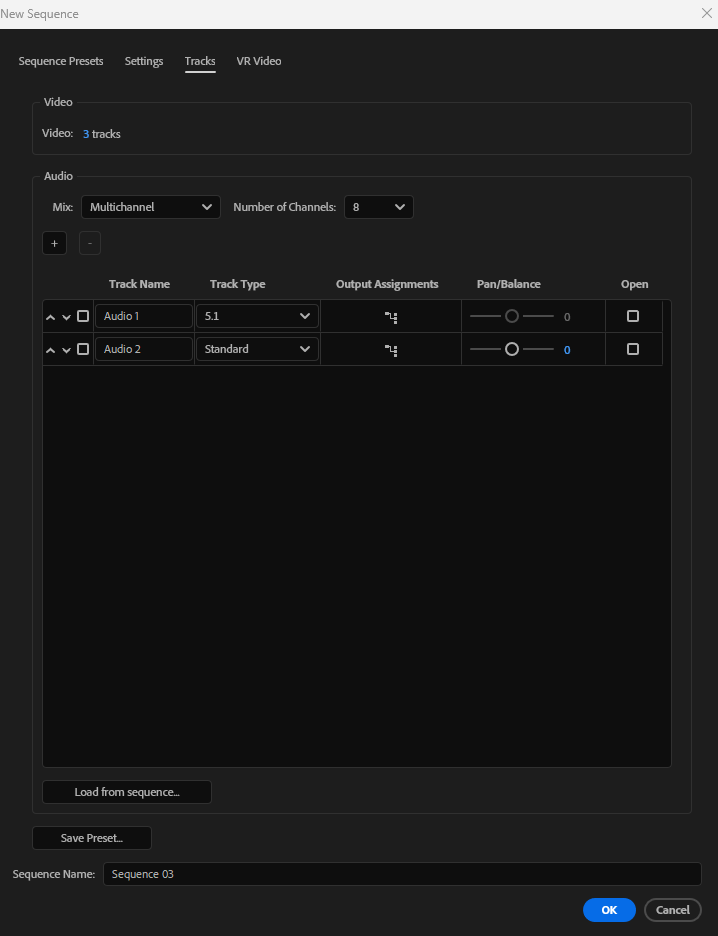

Ok, this is the new sequence. I have discovered that by setting the configuration the way I show in the screenshots, the dialogues are not lost. Then I duplicate the 5.1 audio track I have, on all the assigned tracks. But I don't know if it's the right way. I also don't know if I also have to duplicate the stereo track once.

This is what I have just done:
Make a new multitrack sequence with 8 tracks
Click on the Output Assignments for the 5.1 and use these settings:
Do the same for the stereo track and send it to 7-8
You can now add the audio files to your timeline, 5.1 on Track 1 and Stereo on Track 2
This is the track mixer showing the routeing:
You can now export the file and it will give you an 8 track audio master with the surround on tracks 1-6 and the stereo on 7&8.

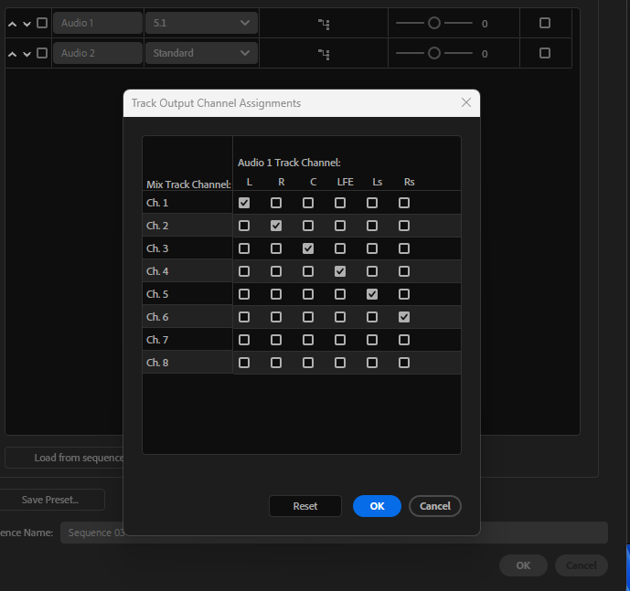

Hi, Richard! Thanks for the help. The funny thing is that when I do it your way, the voices disappear. I don't know why it is, everything is the same. But I have discovered that, as I specify in the screenshot, if in 5.1 I put each channel only in one place instead of all of them (repeating it once for each channel) and then I duplicate the track, then everything can be heard correctly. I have exported a test and I think everything is correct.
