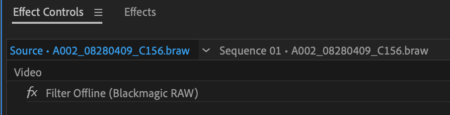

Initially, my Premiere project crashed.  Upon restart, Premiere prompted a message that said the project crashed due to the Blackmagic RAW plug-in and gave me the option to launch the project with the plug-in disabled.  I clicked disable.
Now, I am completely unable to re-enable the plug-in.
This is how it appears in my source window: "Filter Offline (Blackmagic RAW)"Screenshot 2024-08-28 at 3.26.31 PM.png

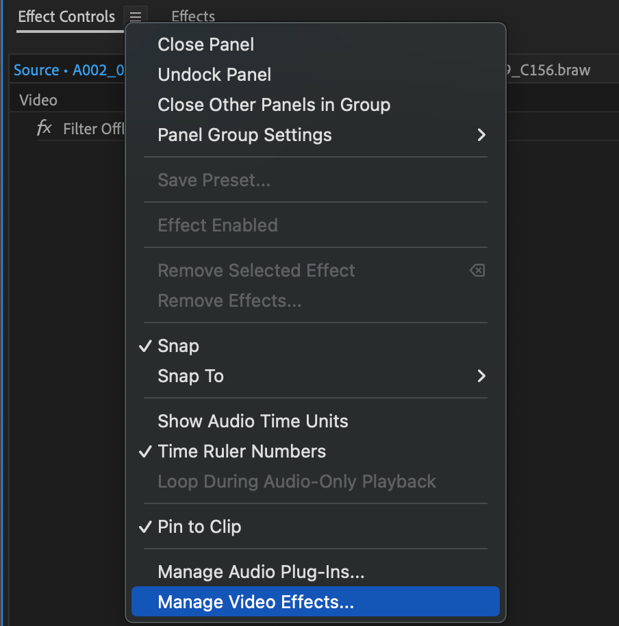

I attempted to re-enable the plugin by navigating to the following "Manage Video Effects" section:

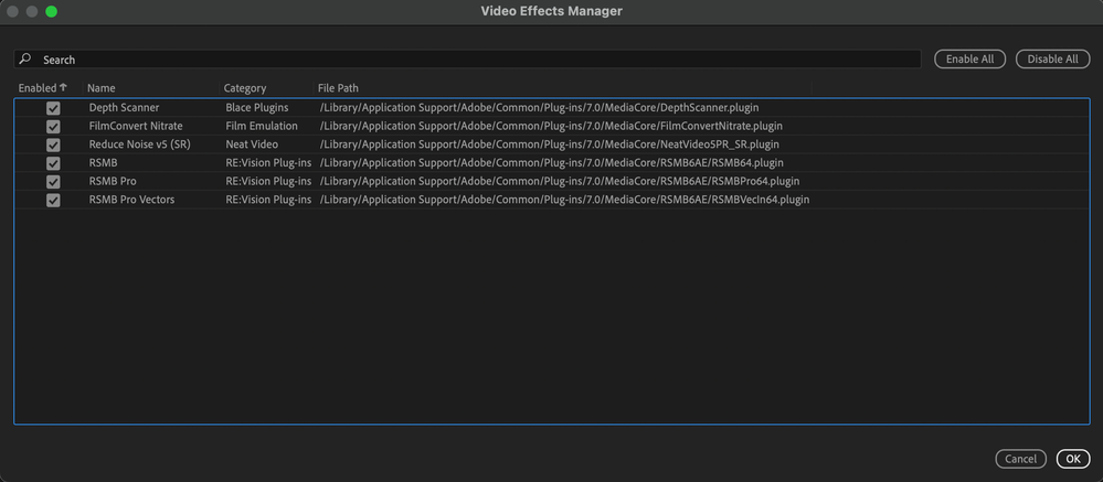

However, as you can see the plug-in doesn't even appear in the Video Effects Manager:

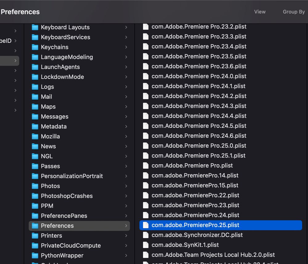

I found the solutiuon to this issue, well for me this worked.
Since I have another computer I sometimes edit on and Blackmagic RAW was working fine in Premiere on it, I narrowed the issue down to the settings - the Preferences.
After trying a few things I went into my Library folder, the hidden one on Mac. For those that don't know, go to your Desktop and press Option and select "Go" in the top menu bar. It should reveal the Library folder.
After looking in Application Support/Adobe and finding nothing, I went into the Preferences folder and found the Preferences for Premiere Pro. I deleted any preferences that populated during and after the crash where I disabled the plug-in. I went as far back as 2024 to be safe since I haven't really changed much of my workspaces.
When I reopened Premiere I did not get the error saying that the filter was not found, but I also did not see the BRAW panel when I selected footage that was in the File. I imported new footage and the Effects Control panel returned.
Now I may have deleted a few other things, but I'm pretty sure it was the .plist files shown here that were causing the issue.
