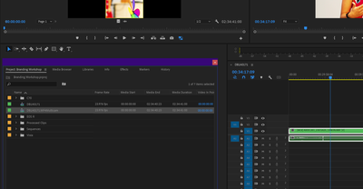

I combined two clips (one UHD, one HD) into a multi-cam sequence, and edited it in a HD timeline to cut back and forth between the two clips. The UHD clip is a medium-closeup shot and the HD clip is a choker shot. In order to get the UHD parts to not get cut off, I had to manually select each segment and fit it to the frame. Is there a more efficient way to do this?
Also, I'd like to take advantage of the fact that the medium-closeup clip is 4K to do a zoom on it over the length of the clip. Is there a way to do this?

In your project window, right click on the "Multicam" thing that was created after you built your multicam sequence. Click "Open in Timeline". This basically brings up the nested sequence that was created. Then you can go to whichever clip and make the adjustments. Those are then reflected in your mutlicam sequence.

You'll have to adjust the original clip in the Source Sequence.  Right click on it from the bin and select Open in Sequence (or Timeline, I forget).
Apr 28, 2018 Apr 28, 2018
double click on your multicam sequence, this will open the source sequences,
right click on the sequence you are referring to and set to frame size or adjust
its scale from the effect controls panel. This will update its size in the multicam sequence

Running into this same issue. If you go to the multicam sequence and click on the panel you want to zoom in on.. go to Effects.. Scale.. set to 150 or whatever. It scales ALL the clips in the multicam. There has to be a way to do this.

You said to double click on your multicam sequence.  All this does it brings up the video in the Source window. No timeline comes up when you double click that so you have no way of selecting a clip in order to see it's effects detail. You have to right click then choose "Open in timeline" to edit the source clips, change the effects properties etc.. Neither of your replies mentioned that important detail.

The video prepared will show the standard way of creating a multicam sequence (all over youtube they use this method)... and when double clicking doesn't work. We used different workflows.
Also, even if you drag that "Multicam" sequence to the timeline and double click, that still does NOT work.. you must right click and say "Open in Timeline". So for anyone using "Create Multi-Camera Source Sequence" in Premiere.. my answer is correct. For someone who does your method of selecting clips ALREADY on the timeline and selecting to Multi-Camera.. your solution works.
