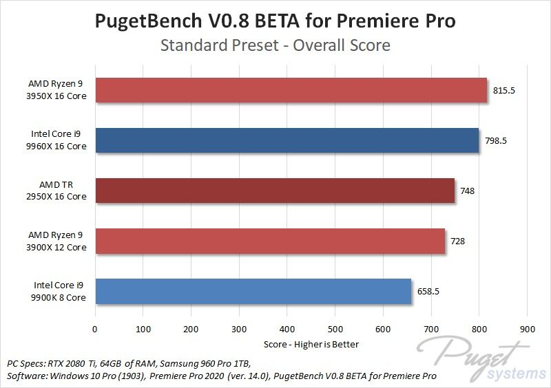

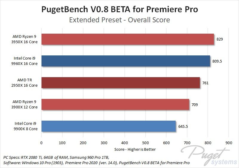

P.S. You should really take AMD seriously. Things have changed drastically in the last months.
As well as:
https://www.pugetsystems.com/labs/articles/Premiere-Pro-CPU-performance-AMD-Ryzen-9-3950X-1615/
