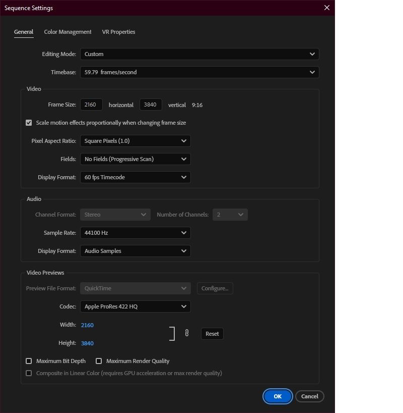

I imported the iPhone footage and dragged it to the sequence timeline and Premiere automatically created these settings for it:sequence settings.jpg

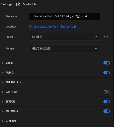

And I used these output settings:

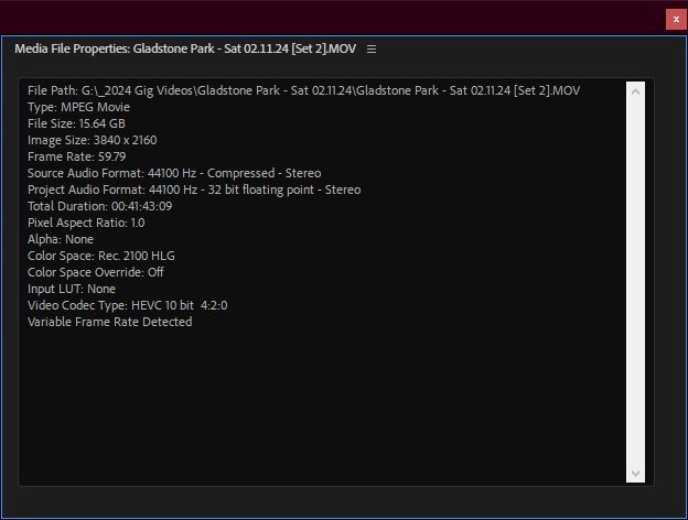

My iPhone footage has the following properties:

Your footage is 3840x2160 but you are using a sequence that is 2160x3840 and export using the 4K UHD Preset that is 3840x2160.
Thumb of rule is to use a sequence that matches your source footage, iow sequence set to 3840x2160 and export to 3840x2160 as well. Any deviation from this will give you black borders.

Hi Mark,
As suggested by Averdahl, to solve this issue, you would need to match the frame size of both the sequence and the export. You can change the Frame size under Sequence Settings to match the Frame size of your media. Hope it helps. Let us know if you have any questions.
