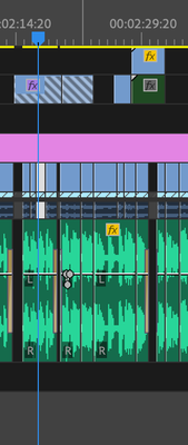

Left audio only in timeline, but both left and right audio in source. Help?
New Here ,
Dec 24, 2018 Dec 24, 2018
In premiere, the audio file that I have is only playing from the left side. I have followed all of the YouTube videos on how to fix this, from modifying the audio channel to adding the "fill right audio with left" effect. After adding the effect, the audio file in the timeline still only plays from the left, but in the source it shows that both the left and right audio channels are filled. And when I play the audio file in the source window, it is playing from both the left and the right. So basically, in the timeline, I only get left audio, but the source shows both left and right. Any ideas on how to fix this or what I need to do to make both sides play in the timeline? Thanks!!

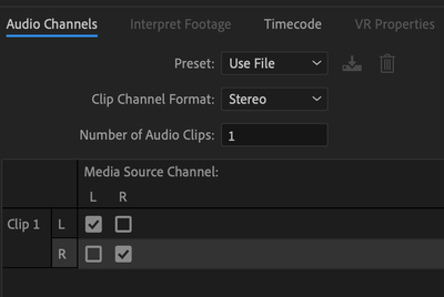

Ok I'm losing my mind here.
This is what the clips currently look like under the "Modify Clip" panel. The R channel was unchecked so I tried checking it but they still just play back in dual mono:
BUT when I bring in the exact same clip the L and R channels are arranged differently - how they were before this bug ruined my day (playing back in proper stereo).
This is insane. So there's no way to get my stereo clips back in action without manually bringing them all in fresh?! (and lose all my keyframes, effects, etc)
What is going on?
