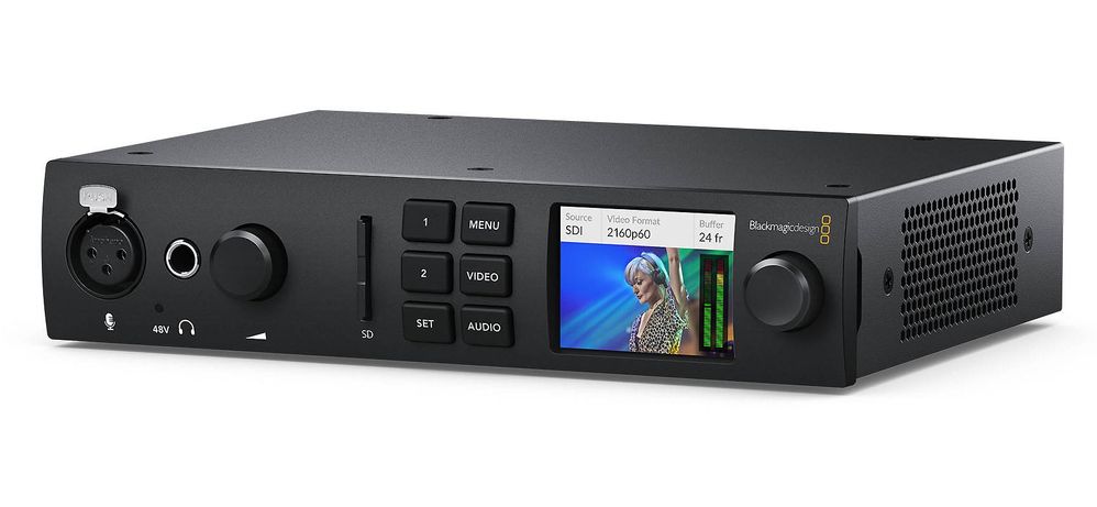

You are very very confused. You need to comprehend what is being done. No one is saying you need an old CRT monitor. You need to learn to pay attention and comprehend what is being said and done. Did you some how miss the fact that you can output to an HDTV using the Intensity Shuttle? The 4K Mini Studio (link below) supports NTSC and PAL (CRT TV/Monitors). You know what it also supports? It also supports ATSC, ATSC 3.0 and Digital Cinema (DCI).
You would only use an older CRT TV to capture old 3/4" tapes or Betcam tapes because it is much better to see SD video on the SD TV as opposed to the computer screen or an HDTV. Do you now understand when to use an HDTV VS an old school NTSC monitor or are you still confused?
https://www.blackmagicdesign.com/products/ultrastudio/techspecs/W-DLUS-11
