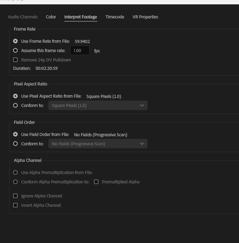

Hi @RedBengal - For the media that you are having issues with can you right click and select Modify > Interpret footage then post a screenshot.

Screenshot 2025-08-12 203338.png@jamieclarke  Sorry I've been away from this. Here is the screen shot. Right now it's just this one file, that I have three seperate clips from in the timeline.
