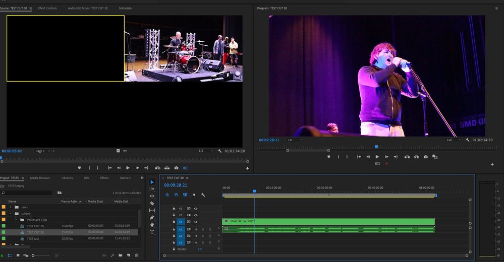

I have been editing a multi-camera sequence in Premiere CC 2017. Everything was going just fine but now I don't seem to have the two views to choose from in the program window. It is only showing me the one camera shot what happened? I really need that second camera back.
I followed the process for creating a multi-cam sequence. And like I said, it was working just fine until I obviously clicked something that got rid of the second camera. The program window is set to multi-camera. And it's enabled.

Here are some additional screenshots to hopefully present my issue better.
Here's what my program window looks like now. (only one camera showing)

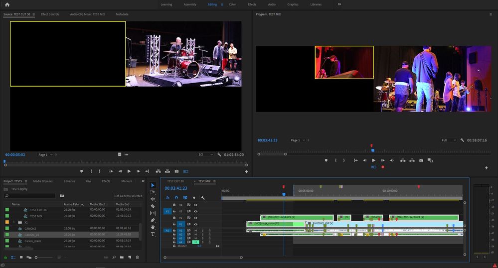

Here is what I want it to look like again. (I created a whole new project to get this screenshot.)
I created a multi-cam sequence and that what's I was using. I just don't know how I went from having multiple camera angles to choose from to just one.
Here's the sequence I'm using. And you'll see I even duplicated it with hopes that it would give me back the second camera angle. It didn't.

Jul 06, 2017 Jul 06, 2017
I think I found a possible solution thanks to a post on YouTube (Fix Multicam Sequence not working Premiere Pro CC 2015 - YouTube​)
To summarise, the multicam video track (V1) was not targeted and a different video track was targeting in the timeline.
I made a test project and a new multicam source sequence and a new sequence from it.
Multicam source sequence opened in the time line
New sequence from the multicam clip
So far that's normal. Note the multicam layer is targeted by default (the blue V1).
Sequence with multicam and another video layer targeted
The multicam view works as expected. Any other video layers can also be targeted as long as the multicam layer (V1) is still targeted.
Sequence with no video layer targeted
If the multicam layer is untargeted and no other video layer is targeted the multicam view still works as expected.
Sequence with non-multicam video layer targeted
If the multicam layer (V1) is untargeted and a different video layer is targeted the multicam view no longer works as expected.
To fix, just target the multicam video layer again.
