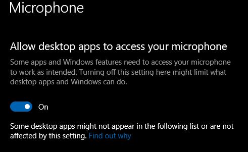

And perhaps more importantly, on the Privacy Microphone apps panel, have you scrolled all the way to the bottom? There is a separate switch to turn on the microphone for "Desktop Apps" - Premiere should be listed here specifically as well. I was getting that same MME error until I did this. (This switch is way below the "Allow apps to access your microphone")

I had the same issue after a windows update.
Setting the switch to on fixed the issue.

Many thanks, looking closely to the Privacy Microphone screen, I definitively do not  have the setup for desktop apps as your screen copy shows. and no list with Premiere Pro or other desktop apps.
My windows version is 1809. Could it be the problem ?
Is there an other way in 1809 to authorize desktop apps in version 1803 ?
Should I force the windows upgrade to 1903
Thanks for your help
Jul 02, 2019 Jul 02, 2019
I am on 1809 and the list does not show Premiere (no need for) just set the general switch to on.

It shouldn't be happening to you just because you're on 1809. In fact, mine only started that recently, and as Ann mentioned, it started with an update and it cut off Premiere's access to the Shure X2U. It may have been a minor update that broke it—not the feature update to 1903 I can't remember exactly when it happened.
What you could try...
There should be microphone icon that pops up in your task bar showing you when an app is trying to access your microphone. If this is turned off in your taskbar/icon settings—turn it on, start Premiere and see if the microphone appears. Then mouse over that icon and double-click it to open the privacy settings and see if it gives you the option to whitelist Premiere.
There are probably registry hacks that will fix it, too.
But yes, if you are certain you don't have that entry for desktop apps below the list of apps, then you could update to 1903.

Everything worked fine and without any upgrade problem, the microphone problem IS SOLVED
My Shure Mic is now in the list and works fine.
The additionnal switch for microphone access for desktop apps  is now present and on.
