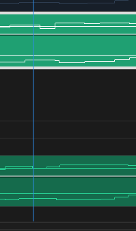

I make music videos so I time clips very specifically to songs.
I need to match an original audio file exactly to a re-encode of the same file. I’ve clicked on show audio time units and have been nudging the clip as precisely as I can. But for some reason I can’t match it exactly.
Here’s a screenshot showing what I mean:
If I nudge the clip left or right, even when showing audio time units, it will go too far in either direction so the waveforms never match up. The difference is very small obviously but I can notice a difference in parts.
Is there any way to be more specific with the nudging here to make it fit exactly? Or another way to make it match the other file exactly?

Yeah, the screenshot above is the audio at the maximum zoom. Basically, the trough that's next to the playhead at the top in that screenshot- I want to line that up with the trough in the audio at the bottom. But I'm already at maximum zoom and nudging it with alt-arrow keys moves it too far in either direction.

Click the hamburger (three lines) next to Sequence name, check “show audio units”, turn off snapping by un-highlighting the magnet icon or hitting S (magnet icon found under time display under sequence name), then you can manually move the track by milliseconds.
Et voilà!
