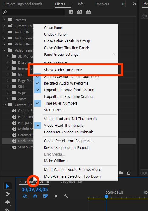

Thanks for the hint! Just right-click on the Timeline ruler and deselect 'Show Audio Time Units' - this changes cursor key behaviour back to frames.

Do it like this. Right click on the Sequence tab and unselect "Show audio time unit". Did you solve the problem?

Genius!!!! Worked for me too.  Very Grateful!
