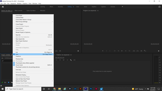

So resetting did not work for me. if you change your menu options from freeform to icon it will fix it. In the menu from that box where the videos are shown it will list "LIST, ICON, FREEFORM" options select to ICON. PROJECT MENU LEFT HAND CORNER BOX
