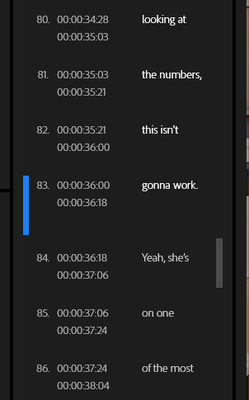

Hi, this problem still doesn't seem to be fixed in Premiere Pro 25.1.0 (Build 73). I'm getting random spaces after lines in captions even though I made sure there were no extra spacings there in the transcription window.
