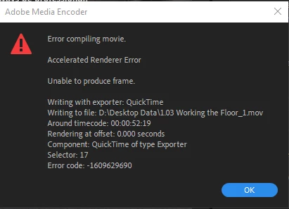

When using both the Media Encoder and Premiere Pro to export sequences, they would either crash, notify a failure, or the resulting footage would have offset clips that doesn't resemble what I see in the playback of Premiere Pro. This would all happen using Software Only.
GPU Acceleration, however, does not work at all. The export will immediately fail and move on to the next sequence, only for it to fail again. Supposedly, this is not an issue with Premiere's sequence settings nor export settings, because the exact same settings work when using Media Encoder and GPU Acceleration on another computer. The difference is this other computer says "OpenCL" for GPU Acceleration. The problematic computer says "CUDA."

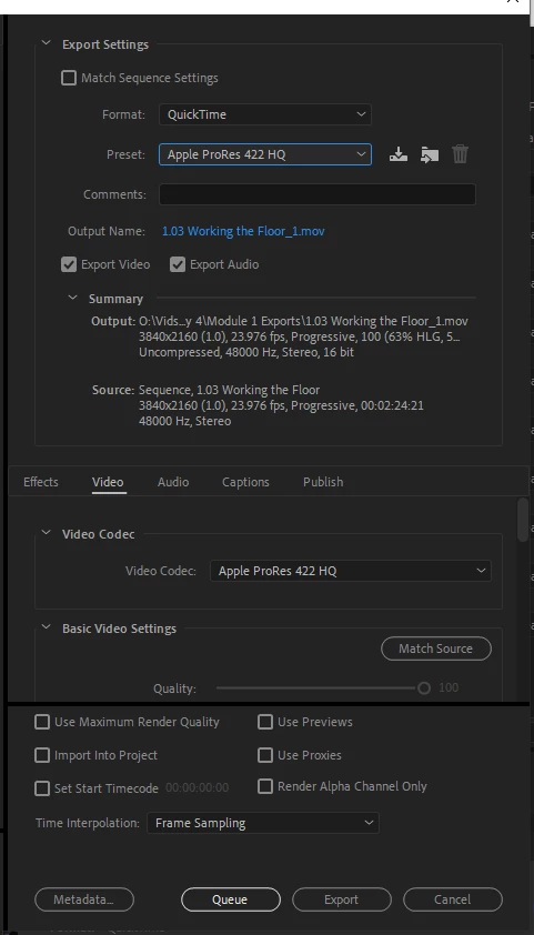

Attached are the sequence settings, export settings (althought this was also attempted with other Quicktime and H.264 formats), and the typical error message.

What happens if you name the output file as 1_03 Working The Floor_1.mov, iow try to drop the period after 1. I have seen that before, that period(s) in the file name cause errors. It´s worth a try.
If it still fails, create a new project and use the same video files as the source and skip the .mp4´s and the .jpg´s and the RG effects. If it works, add the .mp4´s, test again. If it works, add the .jpg´s, test again. If it works, add the RG effects, test again.

The time-codes usually lead to the very beginning of a sequence. The one above says the timecode is 00:00:52:19 because this is a subsequence from a stringout sequence. Almost every time, the render fails right at the beginning of a sequence/subsequence.
