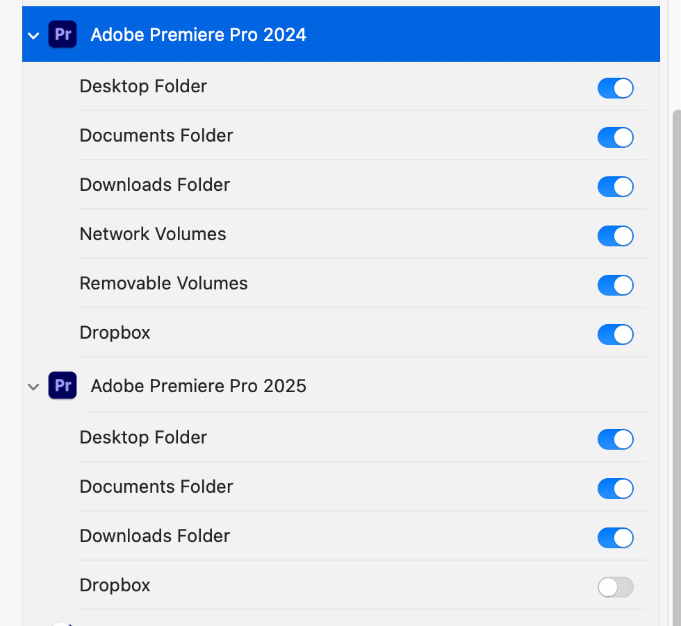

I have Mac Os Sorona and I just upgrade my Pr Premier Pro  to 2025. I went to Pr Pro Settings  and click the Dropbox button. Thats allScreenshot 2024-11-25 at 9.29.02 AM.pngScreenshot 2024-11-25 at 9.31.50 AM.png

Hi Jacob my mistake I never put the root .
Apple system settings/Privacy and Security/Allow Accesories to connect /Files and Folders
You'll find a list of all the apps then you select wich one you want to grant access to dropbox
