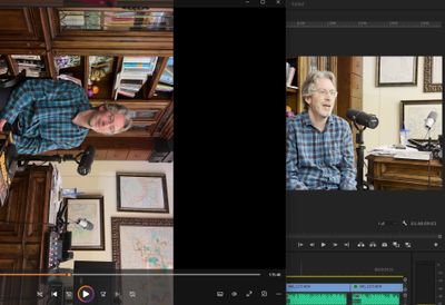

I'm having an issue with how the Rec 2100 HLG is being displayed in Premiere. Note: this is not the common issue of needing to set to correct color space in project settings. Everything is set correctly.
But it seems despite this, as the screenshot shows, if you play the footage in Windows Media Player for example and compare to the display in Premiere, it looks a bit desaturated and overexposed. This happens with exported files as well, even when they are set to correct color space.
Again to be clear this isn't the issue of it being set to the wrong color space in export because then it's extremely overexposed and blown out. Here it's a bit more subtle, but still quite noticable to be an issue to my client.
Also there is no extra LUT or color grading preset being applied here. It's the natural raw display. Any ideas?

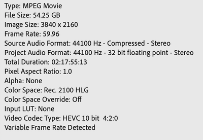

Participant , May 12, 2024 May 12, 2024
OK super weird. So today woke up and noticed that now everything lists as 2100 HLG in the color settings and that "color spaces match". Initially it was super blown out and I was confused why everything had changed, then I clicked "extended dynamic range monitoring" and now it looks closer to the source footage, and that detail I was talking about in the beard etc seems to be there now in Premiere! šŸ˜„

What does it look like if you play the export in Premiere?
Participant ,
May 11, 2024 May 11, 2024
It looks the same, has the same issue playing the export in Premiere.

Would you mind telling your sequence settings and deliverable intent? Is it Rec.709 or Rec2100 HLG? From the screenshot it simply looks like no conversion is applied and no display management either. You are simply looking at the HLG encoding as is which looks greenish and desaturated. If you want to create SDR video the sequence should be set to Rec.709. To view and manage it properly Auto Tone Map should be enabled and the clip interpretation should be set to Rec2100 HLG.
Participant ,
Deliverable intent is to keep to the Rec2100 HLG color space. As you can see the sequence settings are set to that and Auto Tone Map is enabled.

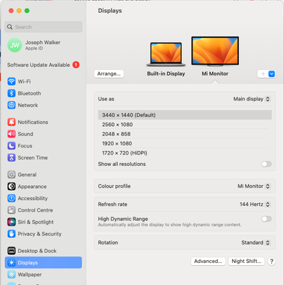

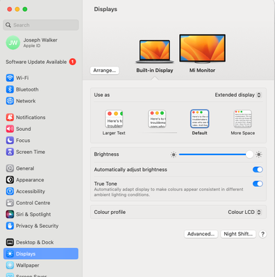

Participant ,
I have two laptops, and therefore two displays I'm working with. A Macbook Pro 2021 M1 Pro (which Apple says as long as 2018 or later is supported) and a Windows Lenovo machine which does have HDR, but I have to check it on in display settings. I'm not sure about client's display.
Interestingly, when the Windows machine was set to SDR it still looks good (as shown in screenshot in the OP) in the Media Player (and notably an Dolby Vision icon appears).
As for the display color management box, when I tick this even with HDR enabled in the display, it looks even more blown out.
Your macbook is probably the only capable of proper HDR signal. Make sure it's set to XDR P3 1600nits preset in the display settings and that display color management is ticked in Premiere.
That's because like I mentioned, video players auto convert HDR to SDR with tone mapping of their own to make it look good.
That indicates that the display of the system you were viewing it on is not HDR.

Participant ,
Update: good hunch, it's displaying on my Macbook Pro correctly!! And now when I check display color management, it looks fine. (And yes the Mac defaulted to those display settings). šŸ˜„
I wonder if that's because the Windows/Lenovo machine had the wrong HDR preset, or if it's not capable of accurate signal due to hardware.
Now time to figure out export settings, will keep you updated!

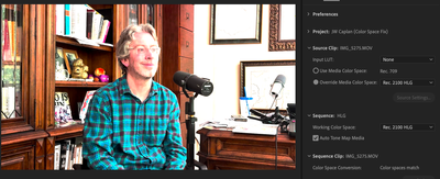

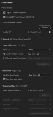

Participant ,
Something strange I just noticed in Lumetri Color settings, says "color space conversion rec 709 to rec 2100 hlg" even though both the source footage and sequence settings are rec 2100 hlg?
Screenshot 2024-05-11 at 10.38.43 AM.pngScreenshot 2024-05-11 at 10.39.09 AM.png
Detection may not always work with every recording codec and/or format. If it doesn't you'll have to manually assign it via Override Media Color Space. You should be able to do this in batch through selecting them all in the bin, right-click modify -> interpret footage and change it there.
Participant ,
Hmm it looks like it's already correct there.
And then if I try the override in the Lumetri panel it looks awful.
Perhaps a bug then and applying it in the settings creates an unnecesary conversion. I never really deal with your scenario so just guessing here. If you're sure that you're viewing the HDR content as it should and the deliverable looks equally good when viewed on the same HDR screen you're probably all good.
