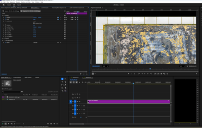

I double-clicked on the footage in the Program Monitor while the Selection Tool was active to see my motion path and anchor point, but they're not showing up.  Why?  I want to zoom out slightly while centered - and in my 2d screenshot have reset Scale from 50% to 40% - but how do I recalculate my anchor point so that it's at the center of the previous keyframe?  In other words, between the last 2 sets of keyframes, I only want to scale - not pan L to R or up and down.  In the 2d screenshot, the image has drifted up towards the left top of frame.  I don't want that.  Thanks for your help!

As for revealing your motion path – I see you have "Toggle direct manipulation" enabled in the bottom left of the Program monitor. That's usually what reveals/hides the motion path. Is your image zoomed in? Try changing the zoom from "100%" to "Fit" and see if it reveals the motion path. Se

To see the Motion Path and the Anchor Point, zoom out in the Program panel.  You can do this by hovering your mouse over the picture and using a middle mouse button or clicking the Magnificaiton pop-up menu at the lower left.

As for revealing your motion path – I see you have "Toggle direct manipulation" enabled in the bottom left of the Program monitor. That's usually what reveals/hides the motion path. Is your image zoomed in? Try changing the zoom from "100%" to "Fit" and see if it reveals the motion path. See screenshot attached to see where to change it.

Thank you.  Zooming to Fit worked.  As to the other part of my question, it doesn't reflect sufficient knowledge or information to warrant an answer.  In an earlier post I had with @LarryJordan and a follow-up exchange of emails, I learned that panning around an image, zooming in and out at different locations was difficult to achieve using one clip, and I had to break up the clips.  I was also hindered by an imperfect understanding of the process.  Now, I'm creating animations to see how Anchor Points and repositioning images work in tandem.  I'm extremely grateful to all the generous people on this platform, including especially and most recently @Conrad_C and @Warren Heaton for their time and knowledge.
