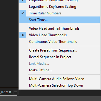

I have the opposite question. Time code defaults to 00:00:00:00 and it is grayed out in the Effects tab. I want to distinguish between several sections of a project and start at :01 hour, :02 hour, etc. and I don't want to duplicate time code.  How do I change the start time?
Apr 28, 2020 Apr 28, 2020
I may not fully understand what you're trying to do, but you can change the start time of a sequence by right clicking the three bars next to the sequence name and choosing Start Time.
Community Beginner ,
Oct 05, 2022 Oct 05, 2022
This served my needs perfectly. I had exported some .srt caption files for social media. The sequences were clipped from longer videos, so their timecode reflected where they were in the original footage. The exported .srt files reflected the timecode instead of zeroing at the start of the sequence. A nightmare to try and correct. Reseting the timeline to 00:00:00 reset the .srt text, and it exported with a zero start. Thanks!
