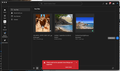

Aug 09, 2024 Aug 09, 2024
I've tried to upload the file to creative cloud and it is too large:
 That or "Some file type not supported"

I really would love to upload to creative cloud but i just tried a 5-10 second snippet showing the obvious banding snippet and creative cloud would not allow it. Does creative cloud not allow .mp4 files? I thought it was the length but it said 'Some filetype not supported'..
That is the exact format that won't export from the exact sequence settings.. Not quite sure how else this can be properly diagnosed.. My bad!

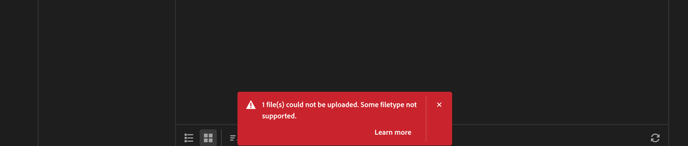

^ Despite that only being 34 seconds, i cannot upload to creative cloud for some reason...
CC says '"filetype not supported"
I'll gladly upload though. Just let me know!

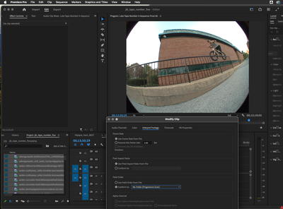

Explorer ,
Aug 13, 2024 Aug 13, 2024
@Kevin-Monahan Found out through Reddit that it wasn't even banding.
Remedy was --> Select the clip in the Project panel and going to Clip > Modify > Interpret Footage.
When there switching from 'Lower Field First' in the project panel on the actual clips to 'No Fields (Progressive Scan)' did the trick! Not sure how the 'Lower Field First' option was on. That is odd to me. The only thing i changed was sequences attempting to troubleshoot.
24,944 frames to render!
Adobe Employee ,
Aug 15, 2024 Aug 15, 2024
Hello @JonathanSchimpf,
Thanks for reporting back. I'm glad you found a solution. Lower-field first is the normal field dominance setting for the dv importer and NTSC-DV. Keep in mind that most people did not shoot progressive as the option didn't even exist until the Panasonic cameras started appearing on the scene (DVX-100, I believe). So for several years, I recall it was all 29.97 interlaced, lower-field first. It might be an issue that your clip wasn't interpreted correctly on import. I'm glad you have the workflow going now that will drive your project to completion. Good luck!
