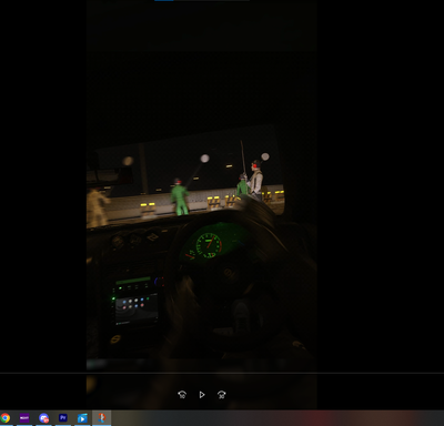

Vertical lines appear while playing the video in premiere and when I export the video the lines increase. But when it is paused you don't see those lines. The recording is fine.

I've removed the gamma effect, and now they are squares jajaja.

I would try highlighting the footage in the project panel and doing a right click/modify/interpret footage and change the fields and pull downs and seem if it helps. If it has fields you may need to change it to no fields or progressive. Or vice versa. I hope that this helps.

Interlaced footage scans vertically (top-down) so the lines appear horizontal, issue here is vertical lines, but great guess as the lines do look like interlaced footage, just side to side instead of top to bottom.

I have found that if I turn on high quality playback, the lines disappear in the preview. But when I export, the lines still appear.

Try putting 3D LUT Interpolation in Tetrahedral in the Project Settings

Had the same problem pop up after an update. In my case, it was a CUDA issue. I changed from CUDA to OpenCL in Project Settings and it cleared right up.

Thanks for the tip, worked for me as well.  Project settings, changed from CUDA to software only rendering.  Thanks again for the tip.

I had this issue and my Renderer was set to Software Only. Once I changed it to OpenCL it went away.

Hi Kevin, I've faced this issue with multiple projects with multiple camera footage types, and have found commonalities to help you guys locate the issue:
  • Only happens with Premiere 2023, I also have 2024 installed and not getting the issue there if I version-up (can't do this due to CC 2023 compatibility required by client)
  • Only happens with proxies for me, not the full-res media. Used the ProRes proxy presets, so nothing custom.
  • Lines are vertical, not horizontal, so it's not a interlaced/progressive issue.
  • When paused, regardless of full/half/quarter paused resolution the lines appear, lower res just blurs them together but getting half the luma... but during playback, regardless of playback resolution, the lines aren't appearing for me. They also don't show up in the render in my case, just a proxy issue.
  • Also getting inconsistent issues where sometimes the lines show when paused in the Program monitor but not the Source monitor, and sometimes it's vice versa and lines show during playback and go away when paused in the Source monitor. Same footage source format, same proxy format, just sometimes closing the project/re-opening moves the bug from one monitor to the other, or on both. And sometimes in the Source monitor I get the lines both during playback and paused, wheras the Program montitor for the same clip on a timeline might only show lines when paused instead of playback.
  • I tried Cineform proxy preset, which removes the lines issue when paused, but then during playback everything is tinted red, as though a tint effect was applied and the blacks were tinted red and the whites were left as white.
The ONLY workaround I've found so far is setting the Renderer to Software Only in Project Settings, but this is not a fix, as I'm bypassing my GPU.
So my conclusion is something is bugged with Adobe 2023 that was fixed for 2024 (I can't use 2024 with this client since I need to match their version) regarding GPU Acceleration/CUDA displaying proxies when paused. It's not a system issue as I saw others using Macs, and I'm on a brand new custom-built PC with 192GB RAM, a new GeForce RTX 3090 GPU, new i9 processor, etc., and working off an M2 SSD so there's no hardware issues. Had the same problem on my last rig with lower specs.
Hope this info helps find the bug to patch the 2023 version, as I'm sure others also have to use last year's version for clients that require projects to be CC 2023 compatible.

go back to mercury playback engine > software only.
files - project settings - general.
it fix it for me..

Thanks. Switching to openCL from CUDAs fixed it, but was a new and weird

Encountered this issue today as well. Vertical lines appearing randomly across all footage in the preview window, which never were there before. Running latest version of Premiere Pro 2023 and the latest video card drivers (RTX 4090 video card). The lines go away if I switch from CUDA to OpenCL... but then the performance abysmal by comparison. I would also like a fix for this issue...
