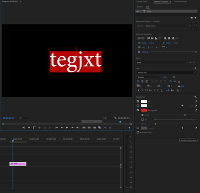

Can you elaborate? I'm creating the text background using the text tool's Appearance settings. I wasn't aware Premiere had alignment tools. How do I select the background and the source text? They seem to be the same object.

Looks fine to me.
Align is for text and separate background. (missed that in the original question).

Thanks. Yours looks fine to me as well.  And replicated perfectly on my end.
When I use a different font (Adobe btw!), I still get the off-center problem.  I'm guessing this background tool doesn't play with all fonts, but it's a bit ironic that it doesn't work with Adobe Caslon Pro ( regardless of alignment: left, right, justified...)

Here's Adobe Caslon Pro on my rig ...
Neil
