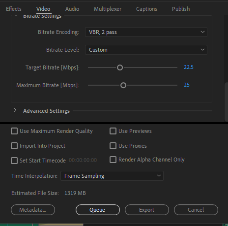

Now, when I got to export it all thru Media Encoder, at the bottom there is a little drop down menu that wants me to select the Time Interpolation....  3 choices,   Frame Sampling, Blending or Opitcal.
What should I check?  My export has regular and slo mo. Seems odd to have to select one at export when the sequence has multi selections.

Community Expert , May 28, 2021 May 28, 2021
just keep export settings (Time Interpolation) at frame sampling
since you are not exporting to different frame rates,
Optical Flow still applies to and affects the clips you assigned that to in your sequence...

The settings in the export settings affect the entire sequence.
You dont check them, unless you are e.g. exporting to a different framerate.

In PPro seq: when I changed the speed of a clip, I would select opitical for the time interpolation for just that one clip.
All other clips are the default 'frame sampling'
But in Media Encoder settings page, it requires a selection to be made.  (can't leave it blank)  frame sampling, blending, or optical. (located close to the bottom of the settings menu)
I'm assuming to leave it on 'frame sampling' but not positive. That selection would throw off the opitical selection for the slo mo clips in the sequence?

I'm not exporting to a different frame rate.
The AME export settings still requires a selection in the drop down menu.
The default is 'frame sampling'.
what did I miss?  The drop down menu is not active? Caz it seems to be active.
If you are not exporting to a different framerate you dont check the boxes, leave it default. Cannot be more simple than that.

I still don't know what boxes you are referring to.
I'm referring to the drop down menu selector that appears to be active towards the bottom of the AME settings pop up page, when you export from the ppro timeline.

ahhhh.  Thank you very much.  That makes sense.
Optical flow in the export settings analyzes the entire sequence not just the clips which have OF applied.
