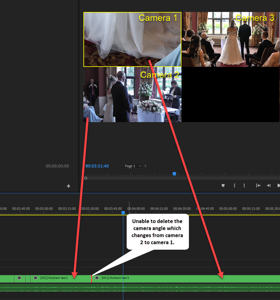

screenshot 003.jpgSorry, I misunderstood.  The clear command, whether from a right click. using the menu, or hitting the backspace key all work for removing a clip from the multicam sequence.  None of the above work for removing the chosen camera angle.
To be precise, if I’m playing back with the multicam view active in the program monitor, and I have camera 2 active, and then enable camera 1.  If I want to remove the change to camera 1, I can’t.
Jun 23, 2019 Jun 23, 2019
Wow! It's best to use the adobe terms so when you use delete it means to delete a portion of the timeline. You're bubble text is not pointing to a 'camera angle' it's just pointing to an edit.
I told you in the post 2 above:
Don't even need to be playing the clip, if the CTI is just sitting over a clip and I select a different camera from the multi-cam monitor, that clip is changed to the new selection. Further I can click any clip and <Del> to delete as normal.
Just sitting there right now as in your image, you are over a camera 1 clip. If you click on camera 2 right now (in the multicam playback monitor), that clip will change to camera 2, and the spot where you have the edit selected would show the sideways hourglass to let you know it's a through cut.

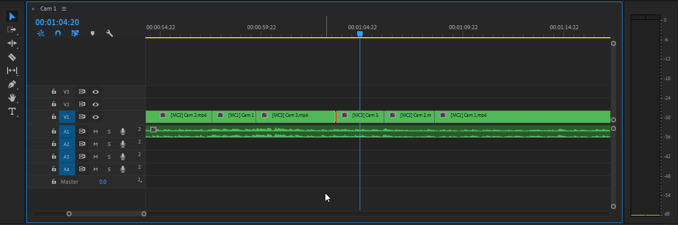

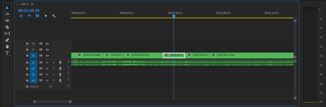

Jun 24, 2019 Jun 24, 2019
Just so.  A picture certainly can paint a thousand words, I should have done that sooner.  As you have explained, there are other ways to achieve a change to the camera view you want to have active.  Having looked at the issue more thoroughly, I’ve learned many new tips all revolving around what you can do.  At this point, the problem is solved using a workaround.  So I’ll try and reiterate the problem and solution more correctly.
Problem:
In a multicam sequence, you have switched between two camera views.  You wish to revert the second camera view back to the original camera view by removing the edit point that coincides with the change of camera.  In figure 1 below, you have changed camera from cam 3 to cam 4 resulting in an edit point.
FIGURE 1
Removing the edit point between cam 3 and cam 4 by highlighting it with the selection tool and pressing backspace/delete does not work.
FIGURE 2
So....move the CTI over the clip (to the right of the edit point) which is currently showing cam 4
FIGURE 3
Using the Program Monitor, select cam 3 which changes the clip to cam 3
FIGURE 4
Highlight the edit point again (same edit point as in Figure 1)
FIGURE 5
Press the backspace/delete key.  Back to a single clip with the original camera view (cam 3)
What should work is going from figure 1 to figure 5 just by selecting the edit point and deleting it.  This is no big deal, but I like to be clear so that anyone else reading this can follow my workflow.  There's plenty instructional videos floating around showing the quick delete edit point, it just doesn't work for me, despite now trying to do so on two different PCs with two different accounts, and two separate multicam sequences made up from different video files. I'd just love someone to tell me if it's me doing something wrong, or is it a bug?
