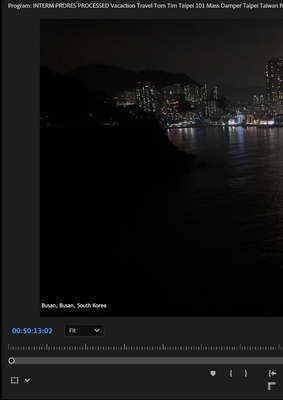

I have been attempting to use this effect to display Metadata burnt into the video;
Specificaly, I had the EXIF tool wrote Metadata into the source Media for location and recorded/created date.
I think there is a bug in the effect;  many fields, will not display in the program monitor, despite there being clear data one can view, and even edit in the project window;
This is the effect setting: (Description will appear Line 1, But Line 2 data will not)
The Project window you can clearly see that there is Data in the Tape Name Field:
The program monitor will properly display Line 1, Description.  But many other fields despite being visable in the project metadata viewer will not display/burn in on the program monitor.
Can someone please advise if I am doign this wrong,  or if this is a bug thats repeatable for others?

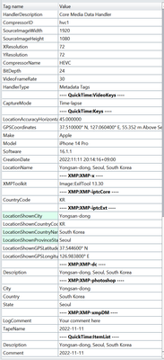

Source Material is Iphone footage.  Metadata has been written/updated with EXIFTOOL;
Here is a sample, its not for the exact same clip shown above, but the same data was written the same way to 141 files, I was just lazy to match up the exact same file, but I assure you this happens on all 141 clips.
