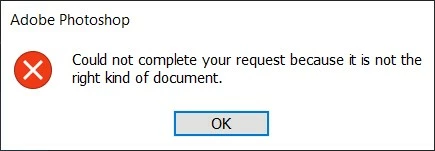

P: Photoshop 23.0 - cannot open TIF files, generated in other programs
Starting from version 22.5.2 Photoshop stopped opening some tif files. The issue is related to a previously discovered vulnerability, the escalation of which, under certain conditions, may lead to arbitrary code execution - Adobe Security Bulletin.
Important: The problem is not with Photoshop, but with third-party software developers who do not keep track of current TIF specifications
A temporary solution to the problem is to convert files in third-party editors that completely update the structure of TIF files (for example, xnView, ImageMagik, etc.); such files can also be converted using the Camera Raw plug-in (via Bridge).
We all hope that Adobe can solve this problem and find a way to bring third-party files to modern standard. But I recommend that you independently contact the developers of programs whose files Photoshop cannot open. Notify them of the problem, recommend to contact @J453 using this community. Jeffrey can provide technical information to developers to solve this problem.

Apparently there are some who have seen issues with PS2022 (v23.0) not opening TIFF files created in Deep Sky Stacker, and not simply having issues with files saved from Starnet++.  I have seen no issues with Deep Sky Stacker, using the default 32-bit/ch uncompressed TIFF file (FITS is an option, but is not a file format normally usable in Photoshop, thus the choice to use TIFF) that is automatically saved upon completion of stacking.  Reading the FAQs for DSS, I learned that 32-bit/ch TIFF files may be saved in a Rational or Integer type, and the author of DSS stated that rational must be used for Photoshop.  Regardless, I resaved the default file to a 32-bit/ch file for both data types, and again PS2022 successfully opened them both, so it seems the DSS FAQ is outdated and Photoshop can open 32-bit TIFFs of either data type.  I proceeded on with each file to process them in Starnet++ under the following test cases:
  1. From PS2022, save the original DSS 32-bit/ch Rational TIFF as a flattened file with a save option for 16-bits/channel and repeat, for each of the Uncompressed, LZW Compressed, and ZIP Compressed options.
  2. Repeat the same but convert via Image > Mode > 16 bits/ch before performing the save...I expect this is the same as a mode change during a save but uncertain, so this was done.
    3. & 4. Repeat the prior two test cases but for the DSS 32-bit/ch Rational TIFF source file.
    These test cases yielded 12 files for processing with Starnet++, which requires a 16-bit/ch TIFF file as input.  All 12 files were successfully processed and the resulting files opened in Photshop 2022, but all 12 files failed to open, the error being the same "not the right kind of document" message.
    For myself, Starnet++ is the only application I use that produces a TIFF file that prior to Photoshop 2022, Photoshop could open the file without an issue.  As it seems the problem may apply to a few select other applications, such as ColorChecker24 or FotoProsto (presumably the OP's applications), and reportedly even Deep Sky Stacker for some users, then it certainly seems the root cause of the problem has occurred in Photoshop 2022 itself.

I'm having the same problem after updating yesterday to version 23. After enlarging images using On1 and saving tifs, they won't open in PS (getting a message that it "isn't the right kind of document). Previously processed and saved tifs using the same program (On1) open fine.

I have exactly the same problem and error message when trying to open files processed by starnet++. This worked fine pre PS 23.0. Starnet++ is a trusted software widely used by the astrophotography community.
