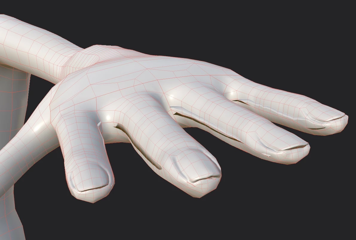

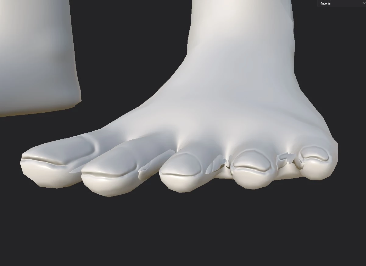

reflection of fingers on the others when normal map baking
Hi there
i have a strange problem when baking maps. i dont know what should i call it (maybe normal map artifact or something). refer to the pics i've uploaded you can see the reflection of the fingers on the others on normal map.
I've tried more than 5 different UV's and baked one after another but all of them had same problem.
all replies will be appreciated.

Can you provide a link to the two mesh files (high and low poly). It may just be the front and rear distance settings need adjustment

Hi Dave
thanks a lot. you were exactly right. i decreased rear and front distances and my trouble solved.
May I ask what is causing this problem? I want to know it so that I can follow it in the future work so that I don't encounter such a problem?
