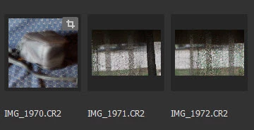

Here is image straight from camera. The first one is captured with live view turned on and it does have crop tol icon in the top right corner of thumbnail without any previous processing or opening in ACR. Next two files are captured with the same settings but through viewfinder and as you can see, entire images are visible without any crop or crop tool icon as indicator. When I open images in ACR the first one is cropped while other two images which are captured with the same settings are not cropped at all. Why that and how to explain? I do not know, I will quite here because I may further confuse someone.

I have Canon camera and here is what I see in Bridge when shoting 1:1 in cr2 and JPEG format, they both look the same: square. Notice the Crop tool icon in the top right corner, that's the key. Raw file still contains data outside the crop while JPEG does not, it is square image without any chance to reset it to normal 3:2 ratio.
