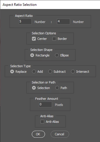

Image processor resizes it does not crop you would want the action that you batch with the image processot to do both the cropping and the sizing.  Actions do the same things all the time the have fixed steps.
I answered this for you in your original  thread you asked the question in.
Cropping could be automated to something logical like a centered aspect ratio crop and set the  document print resolution  to a print the images the same size. The aspect ratio  would be for the images orientation.  Landscape or Portrait for example  a 3:2 for Landscaper would be  a 2:3  for a Portrait and the print resolution would be set for the longest side length.  Some number of inches like  9" so portraits  would be 6"x9" and landscapes 9"x6".
Actions can not deal with size well.  A cropping action would need help from a plug that it could pass some sizing information to.   Adobe does supply one plug-in that Action can use to fit image to some image sized area,  But image retain their aspect ration Nothing is cropped.  No image content is lost the image quality is changed some resizing the image to fit.   So lets say  you have 8.5" x 11" paper if I confine a to the center I know I can resize imaget to fit 8" x 8"  and they will print on the paper.  I want to use high resolution small Pixel.  Let say 300DPI so 8x300=2400px.   So the action could set the image print resolution to 300DPI. using Image size NOT check resample and set Print resolution to 300DPI.  Then the Action could File>Automate>Fit Image... and pass 2400 for with and height.  This will be recorded into the Action step and width and height 2400 will alwaye be passed to the Fit Image Plug-in when the action used used fit image will not displaye its dialog it will just resize the image. My 3:2 Camera inage will prin 8" x 5.33" Lanscapes and 5.33x8" Portraits half of the paper will be white.
What a waste of paper.  Why not print 10"x 8" Landscapers and 8"x10" Portraits. Sone of a gun I have a 3:2 Aspect Rtion camera not a 5:4.  So a wrote two Plug-in scripts for Photoshop to help out Actions. Actually I stole Adoeb's Fite Image script code and changed its function to facilitate Aspect Ratio selection. And Change Print size.   Now Action have no problem  printing 8"x10".
Step 1 menu File>Automate>Aspect Ratio Selection ...
Step 2 menu Image>Crop
Step 3 menu File>Automate>Long Side Print Lengrh...

ahmedfarrag17作成者
August 18, 2020
It works!!!! Thank you so much!!
At the beginning I had some issues with aspect ratio, until I could find a website through which I could convert width x height in pixels into aspect ratio parameters.
It wouldn't have been possible without the "aspect ratio selection" tool you sent me with the direct download link..
So thank you sir for your kindness and for your attention! 🙏❤️
