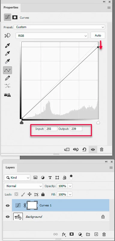

Add a curve adjustment layer and, in properties, drag down the top right point until it reads Input 255 Output 239
Explanation FFFFFF is RGB 255,255,255 and EFEFEF is RGB 239,239,239
Incidentally your image is untagged which means colour values are meaningless. I assigned sRGB on opening it but I would advise not working with untagged images if colour matters to you.
Note : If you see a small color change after saving as jpeg, that can result from the lossy jpeg compression process.

So a bit more explanation. There is nothing magic about Hex codes. They are just RGB numbers expressed in base 16 which counts from from 0 to F rather than 0 to 9 in decimal.
If you add a curves adjustment layer and look in the properties panel, you will see a straight line with a point at each end. just drag the top right point straight down while watching the numbers underneath until they read as shown.
That will take everything that was FFFFFF and convert it to EFEFEF. It will also scale the other values to keep them proportionate.
