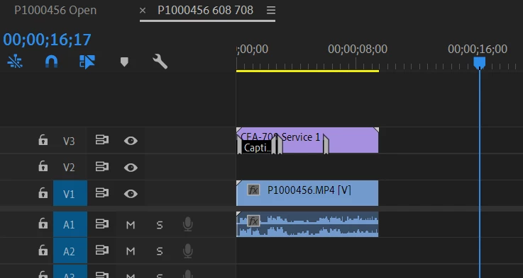

In the first screenshot, I am zoomed out similar to yours: we see the 8 and 16 second marks. In that screenshot, we can see only the ending marker for the one frame and one second captions.

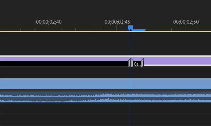

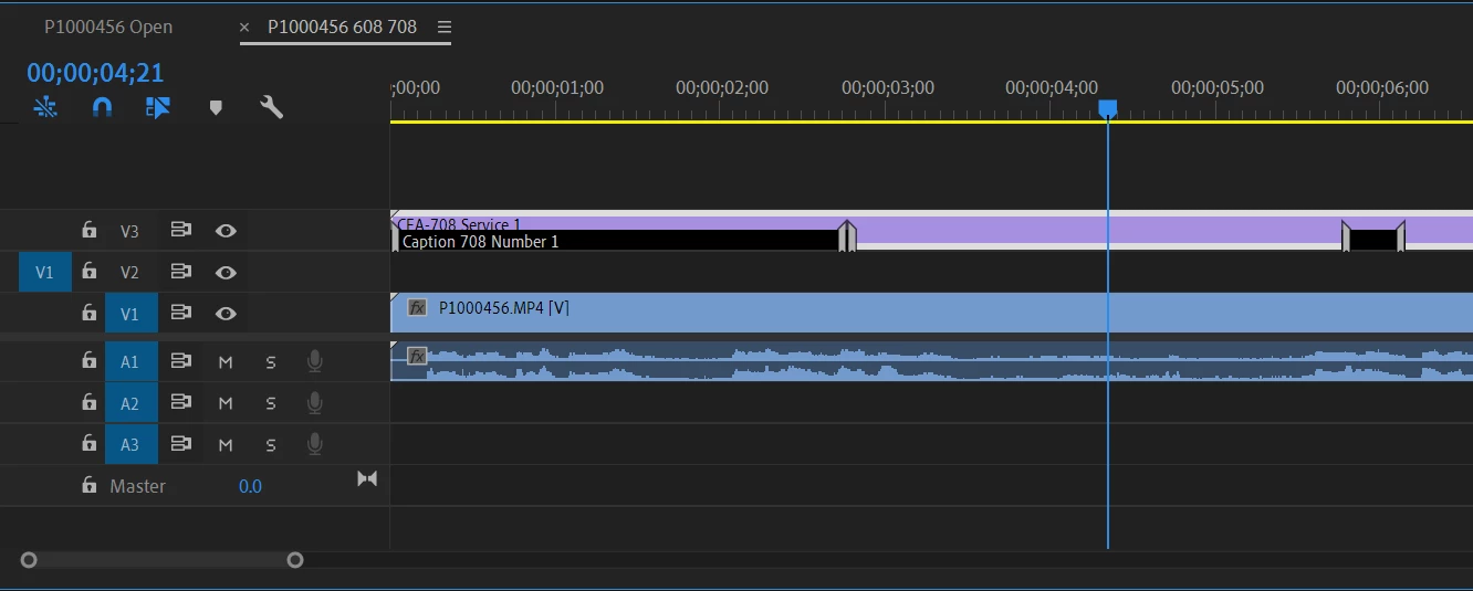

In the second screenshot, I am zoomed in so we see one second marks, and we can now see the one second long caption, but the one frame caption is still just an ending marker.
In the third screenshot, we are at the level of sever frames, and we can see the one frame caption.
