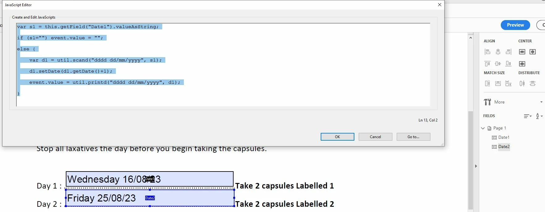

Can anyone help as this does not seem to be working properly:  Im using the code but ammended to show days:
var s1 = this.getField("Date1").valueAsString;
if (s1="") event.value = "";
else {
var d1 = util.scand("dddd dd/mm/yyyy", s1);
d1.setDate(d1.getDate()+1);
event.value = util.printd("dddd dd/mm/yyyy", d1);
This is not pulling from field Date1 though, it is using the current day as input.  Can anyone see what ive done wrong?
try67
August 24, 2023
Are you sure this is the actual value of the field, and not just a formatted value? What does it show when you click into it?

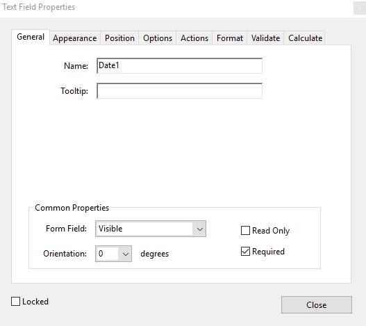

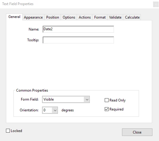

Let's say the fields are called Date1 and Date2 and that the format is "dd/mm/yyyy".
Use this code as the custom calculation script of Date2:

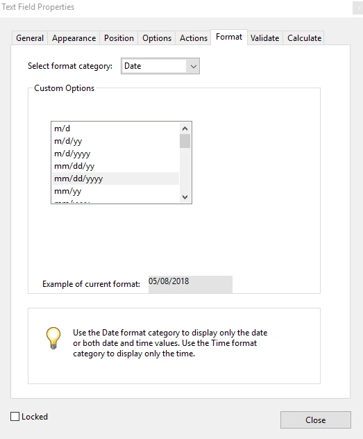

try67Community Expert解決!
May 8, 2018
You placed the code in the wrong location. It needs to go under the Calculate tab, in the third option ("Custom calculation script").
Also, if your date format is actually "mm/dd/yyyy" (and not "dd/mm/yyyy", which is what I used) then you need to change that in the code, too.
