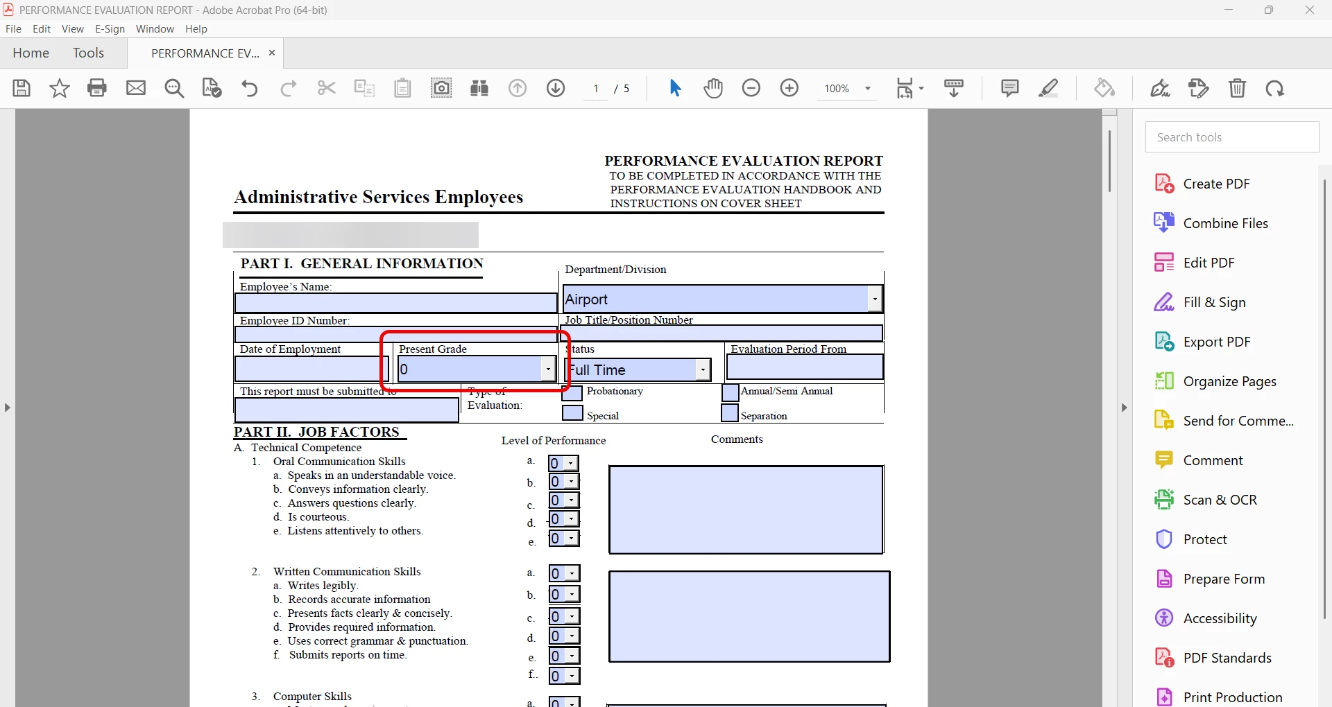

I have a fillable PDF with a drop list of options. The list appears, make a selection, but when you click out of the field the selection I made goes back to zero
The below form has a field for Present Grade.  The field is a drop list.  When I make a selection, the selection from the drop list it appears in the field.  But, as soon as I click out of the field the selection disappears and goes back to zero.

    Is this your form, or are you just filling out somebody else’s form? If you created this form, then there is likely a calculation script somewhere that sets this field and you need to find that script and modify it or deactivate it.
    If you are just filling out this form and you did not create it, you need to talk to whoever gave this form to you and let them know. They may know how to get around this.

    tori_5504Author
    Apr 16, 2026 5:57 PM UTC
    I created the form.  Thanks for your suggestion, I’ll check that out.
    Thom Parker
    Apr 16, 2026 8:09 PM UTC
    Be sure to check for any kind of script or action on this field, not just calculations.
