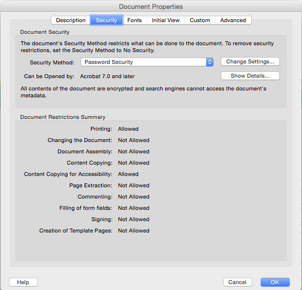

Thank you for you answer.
Im assuming that it is not possible to have both a secure PDF and the ability to compare one PDF to another.
Is there a way to Enable Content Extraction and Prevent Editing to the existing file? I do not mind if content is copied or that the file is printed. Im trying to prevent the existing file from being easily manipulated.
Ive attached a screenshot of my Security Document Properties. Are there preferences that I am overlooking that would make this task possible?
try67
January 17, 2017
You need to enable Content Copying. It's a separate check-box in the
Password Security window.
