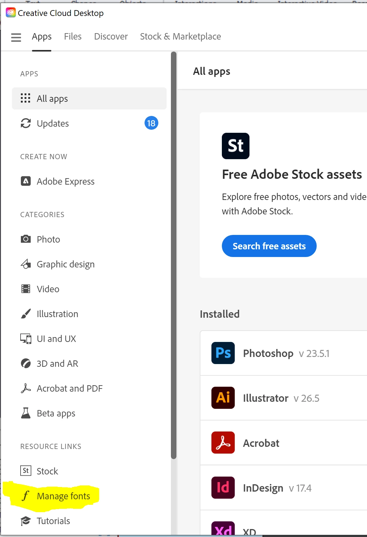

You have the CC application open, check it. In that application you find the option Manage Fonts:
Click that option and you'll be able to find fonts. You can also navigate immediately to https://adobe.fonts.com  Be sure to log in with your Adobe ID (same as for Captivate). You can search for fonts and activate them.

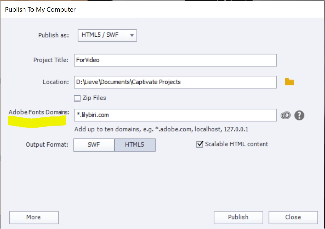

The domain is indicated in the publishing dialog box:

You are entitled to a number of Adobe fonts, included with your Captivate license. Beware: with that license you can indicate only one domain for using those fonts. I am not sure about the amount of fonts, think it is 10. How many fonts do you need?
Why you do need them especially for responsive project is clear: those fonts are always rendered on runtime. For non-responsive projects that is only the case for dynamic text, static text is converted to images which means you can use any font on your system.
Since I have a CC license, my fonts license entitles me to more fonts and multiple domains. One of the domains I would add is localhost. That domain is used when Previewing the project locally. But you'd better use the domain where the course will be deployed (I added my domain, you see that a wildcard is possible).
