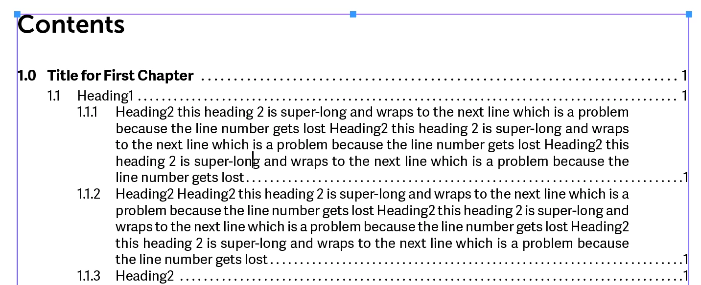

InDesign has clever feature that I wish FrameMaker would add—it's called a last-line right indent—and is meant for your specific situation:
Page numbers get lost in multi-line TOC entries:

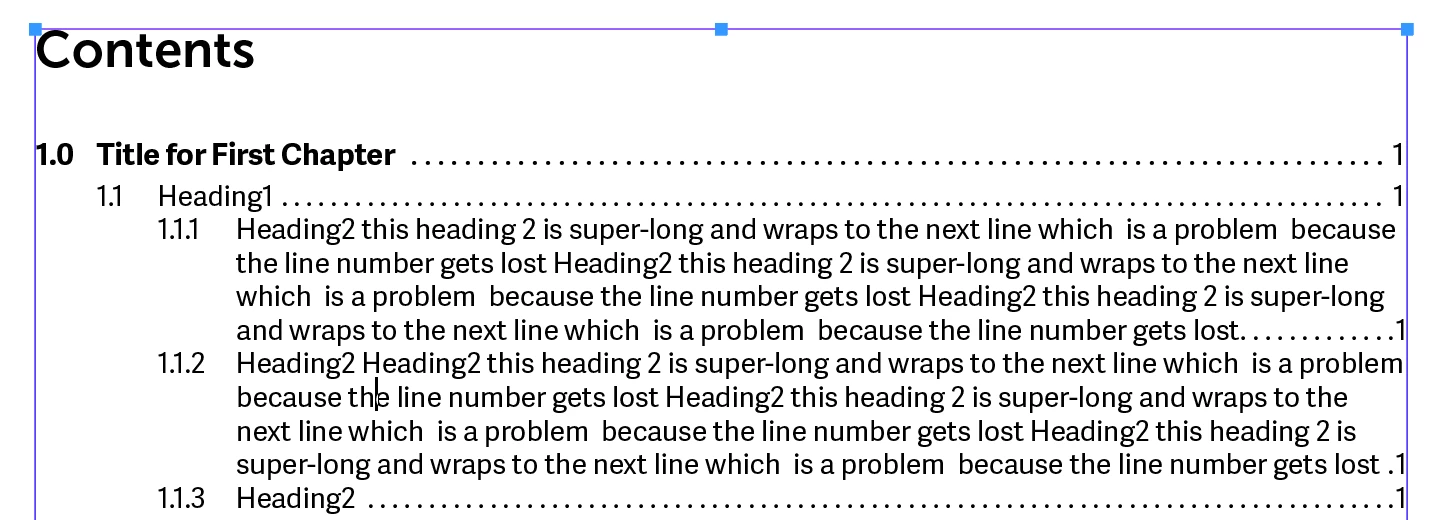

So you can define a right indent pull in all the lines on the right-hand side, and then direct just the last line to go back out.
