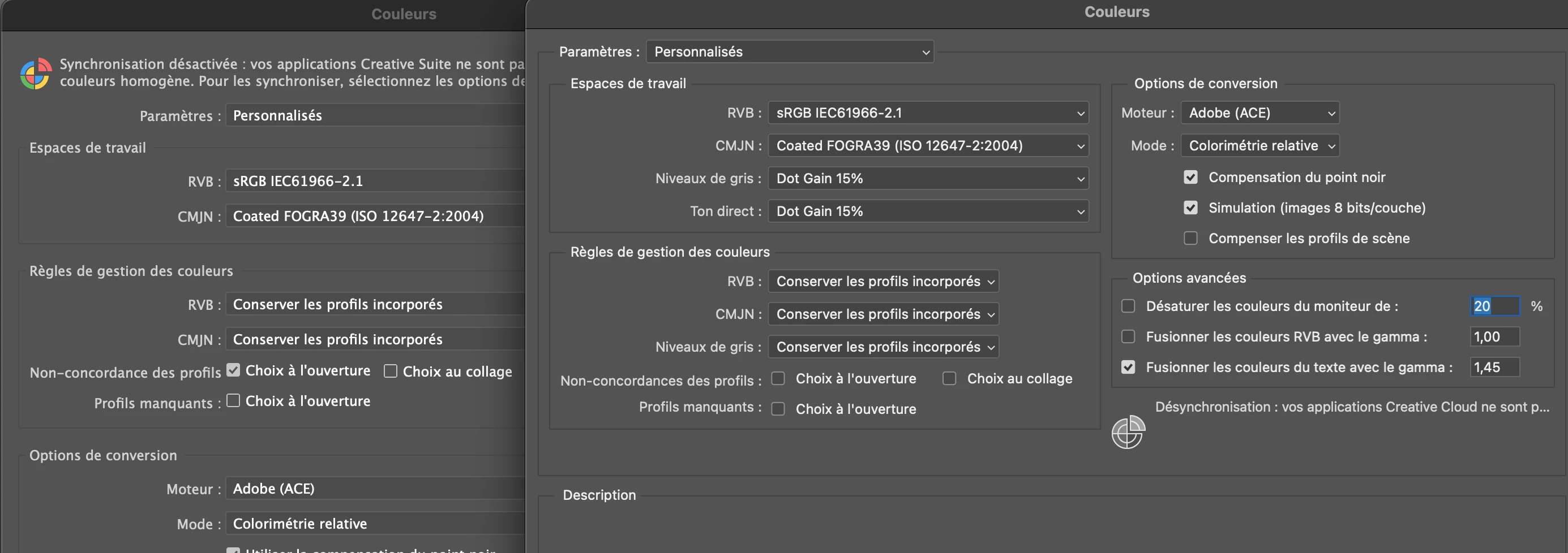

left: illustrator color setting ; right: photoshop ones (sorry the interface is in French, I hope it's still in order for you regarding the color info?)

The problem is that you are not using any actual color management. just arbitrarily switching profiles doesn't mean anything if you're not working in a calibrated environment with proper proof preview.

This is an important point you make here indeed - and I had read this article which has appeared several times in the other conversations about the same topic. But now I'm starting to have doubts: are there any details I'm missing in this article?
Overall, the article says to manage colors in a good environment, talks about screen display and printing tests (I don't plan to print this color so we can remove this point for my problem), etc. But on one same screen it shows me different colors. I wanted to make sure that my Adobe color manager was coordinated to make the color #ff0a54 similar on the other programs, but it doesn't change anything for me.
