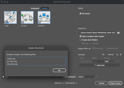

I'm on Illustrator v 29.8.1
I'm getting these screens when trying to export SVG files, have done this for over a decade and, all of the sudden nothing is working for the SVG file format, will not save out no matter what I've tried.
Screenshot 2025-09-21 at 6.57.14 PM.pngScreenshot 2025-09-21 at 6.56.51 PM.png
