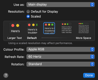

Jan 20, 2022 Jan 20, 2022
I've found that I get better results by doing the below. Not a fix but a work around, I'm still waiting for Adobe to come back to me with a fix.
Change Display Colour Profile to Apple RGB
Good luck, hope this helps.

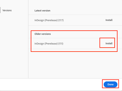

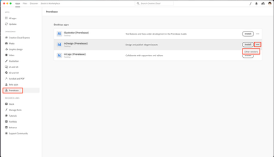

Adobe Employee ,
Jan 27, 2022 Jan 27, 2022
Hi @Rachel Guthrie @imsg,
We are sorry for the trouble and experiences you had. We have tried to address the issue in InDesign v17.1. This update may not be available in a few regions as of now. We will be pushing the updates to all regions ASAP.
I will request you to please be patient and wait for the full public rollout.
In the meantime, the public version gets released in your region, and I will suggest you join our Prerelease program. Please click this link and go to the "Available Program" section to join the InDesign prerelease - (www.adobeprerelease.com/).
Then accept the Prerelease agreement and do the following steps to install the Prelease v17.1:
- Close InDesign
- Go to Creative Cloud Desktop and look for Prerelease in the Apps section.
- Click on ellipses (three dots) near Install to get "Other versions" and install the older Preleease v17.1 (This will not replace the existing installation of Release build of InDesign).
Let us know how it goes after installing this version. We will be looking forward to your responses.
Thanks & Regards,
Anshul Saini
